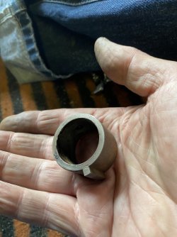

A BIG thanks to Rob and those who said check the trigger rotor (impulse cam 21602103 15) it fell off in my hand once I got the flywheel off. Popped it back on with a bit of blue Locktite 242 on the grub screw. There was an awful lot loose on this bike which only reflects on its previous maintainance.
It runs now but sounds a bit lumpy. Might need a good run to clean the plugs etc. I marked the back plate so was sure I replaced it from where it came. It’s a Bank holiday in the UK and I have a moany neighbour so unless I spot her going out I will leave that till Tuesday.
Hunting this issue down has cost me a battery, set of plugs, a RR and the Ignitech and coils. All for a spot of maintainance. The bike has been shaken to bits.
After fitting the Ignitech I find the handlebar kill switch when OFF won’t let the engine start and lets it run in ON. But the engine won’t stop when then switched OFF if running. I’ll study the wiring diagram.
