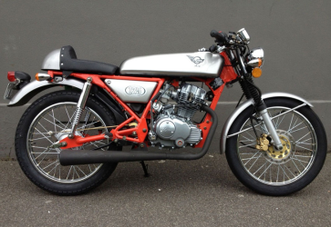

Hello all, I have been trying to get my RGS Corsa to run properly since it's first start in 30? years last month. I cannot get it to run properly at low revs. It goes fine as the revs increase, but it feels very rough and unhappy down low. I strongly suspect the carbs.

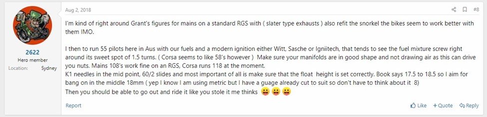

Are 65 pilots standard on these bikes? Very big.
I agree it sounds like blocked idle mixture circuit. The prob is, some material can end up forced further into passages with very small exits, so finding clever ways to blast in the 'opposite' direction to normal air or fuel flow can be effective. Assuming you've checked all three plugs for strong spark? The fact that it starts easily doesn't indicate electrical though.
65s seem pretty big to me as well. if the pilot jets are correct you'll have best running with mixture screws between 1 1/4 and 1 3/4 out. But you need to ensure those passages are clear.
