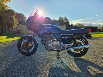

And here's a picture of the bike
cheers, Tony
