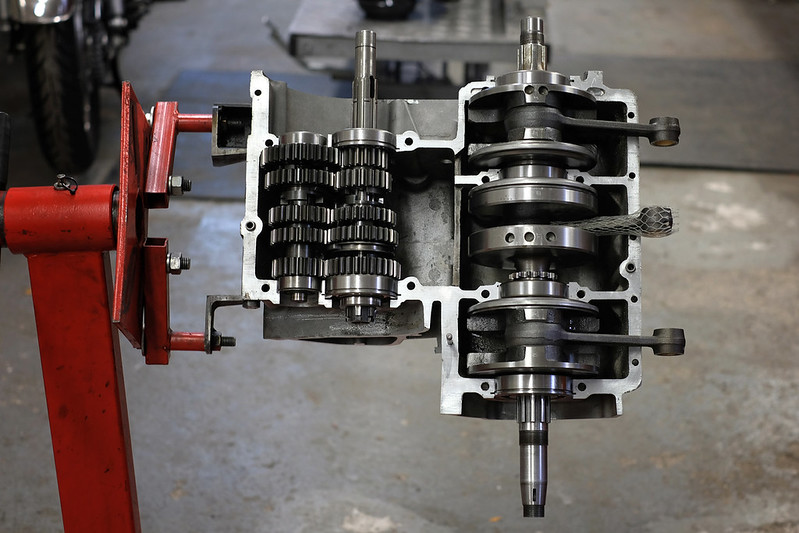

Looks like you applied it as if it was for free! ;)
I use 518 a lot on my brit single, it has the advantage of remaining a little flexible. For Laverda cases, I've used 510 sucessfully for a number of years. A tiny bead, about 1mm, around the outer case edges and around the stud bores is more than enough to seal them reliably.

Ditto Loctite 510. Used it recently on my Jota cases, applied as shown in Piet's pic.
Sets between the joint into a thin, firm film, but remains fluid and is easily cleaned at the exterior of the joints.
Has sealed the cases perfectly, so far.

I like to remember how you completed my engine - including applying the sealant. Unfortunately, my engine doesn't have such nice connecting rods:
Of course I know I got exactly what I paid for ...

OK thanks ... Loctite 510 looks the go. Its anaerobic ... the threebond stuff looks to be a RTV silicone which by my reading is better for sealing large gaps. Hey Piet ... yeah mate I probably do lay it on a little too thick. I hate oil leaks !!
Excessive application of sealing compound doesn't do much in the way of preventing oil leaks, but it wreaks havoc in regard to bearing fitment/clamping. If you have some of that crap still to hand, scrape off a larger bit and measure its thickness! This amount is then missing from clamping the crank and gearbox bearings in place. Spun bearings are quite common, usually found in conjunction with a liberal application of gasket goo. Then there is the excess that finds its way inside the cases, blocking oil passages and filters.
Absolute cleanliness and intact sealing surfaces are required to prevent oil leaks, only a minimum amount of sealant is then needed to complete the picture.

Apparently that Loctite stuff is oil-soluble in its liquid state. Any sealant that gets squeezed out of the joint on the inside of engines will be washed away by oil circulation once the engine is running. So even if you apply too much, the squished-out excess won't block oil galleries. Remember that it sets anaerobically. There's air inside the engine, so any exposed blobs or dribbles will remain as liquid after the stuff inside the joint has set.
Correct Cam,
It is oil-soluble, with very little to no excess to be found in engines that for some reason have to be opened again. Does afford peace of mind, compared to silicon-based sealants!
A thin bead will result in thicknesses of less than 0.02mm If applied liberally, as in applied with a brush, thickness can be as much as 0.2mm! This stuff will not flow readily under pressure, the more you apply, the more will remain in the joint. As in my photo, the sealant will only just appear externally when the cases are buttoned up, hardly anything needs to be wiped off. Of course, this does mean the joint surfaces need to be in perfect condition. I prepare them with a fine oil stone to keep them flat and square. Loctite offers other products that are suitable for reclaiming buggered sealing joints.
