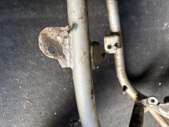

Here’s some outstanding triple side stand engineering, it’s going to be given the cutoff wheel treatment pretty quickly
Clearly the previous owner never cranked it over around lefthanders.
Bit of a shame, but not too bad.
Frame was a factory replacement:
My 79 Jota had something not dissimilar when I got it, didn't stick out that much though. It met Mr Angle Grinder as well.
The best sidestand for these is what the factory did on the 120 Jota - and later similar one on the RGS - as it tucks out of the way of everything. They just put it a bit too far forward, too short tang, and had the stupid suicide spring on it - easily fixed.
I thought about making something similar for my Jota and might still, but in the end was too lazy and/or didn't want to weld onto the frame so did my iteration of the JotaRob / Bushman / et al thing. It's certainly a game changer for the useability of the bike.
