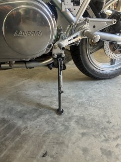

I once built this for a gent with an injured/partially disabled left leg. He couldn't dismount without using the side stand but couldn't deploy the stock stand while sitting on the bike. This was a completely bolt-on solution as he wanted everything to be easily reversable with no welding on the frame. He was very happy with the outcome.

Looks really well made Piet.

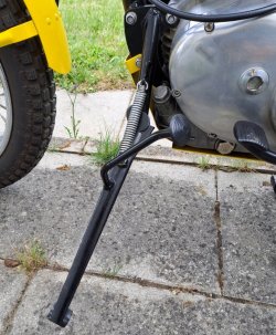

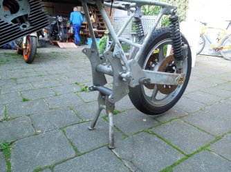

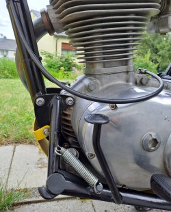

The most recent job I did was a side stand for a mate's "Bural" (Ural with BMW engine) last year. I opted for a bolt-on sub-frame between the frame rails to mount the side stand pivot on. It wasn't a particularly neat looking job because a clunky-looking fitting suited the bike's "steam punk" character. I actually used a hex head bolt as the stand's toe lever just to accentuate the clunky aesthetic. I've attached some pictures below for your amusement. I don't remember what the stand itself originally came off. It's one I'd had hanging around in my spare parts junk heap for years. I don't even remember how or when I acquired it. I'd guess it's off a Japanese bike of some sort and was discarded because the pivot was flogged out. I had to make up a new bearing bolt and then weld up the pivot hole and re-drill it to suit the new bolt.

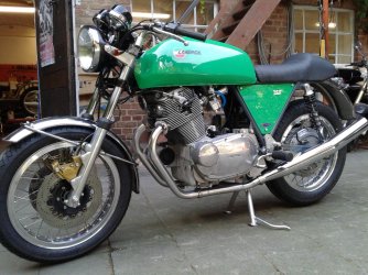

While speaking of stands and the difficuty in making them, the owner of this beauty dearly wanted a centre stand.

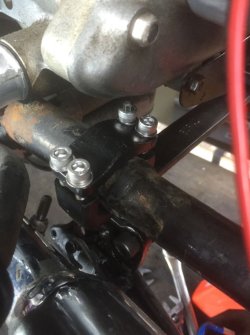

So, apart from restoring it from a rusty wreck, I needed to come up with a way to attach the stand in the first place. Anybody knowing anything about Eglis and their derivatives will realise there's nothing but open space under the engine and no frame whatsoever... As a SFC 2-2 exhaust was to be fitted, I decided I may as well use the post-74 SFC item instead of making one from scratch. Making a mount was a whole different matter. I used a large bore, thin-walled tube as a cross member between the engine plates (these were custom-made from 10mm sheet to replace the weedy 1/4" stuff originally used), needing to create clearance for the chain run. This entailed making completely different mounting plates for left an right hand sides. While the RH plate is the bare minimum required for overall stability, the LH plate takes up the majority of torsional forces that arise when the bike is lobbed onto the stand. Lugs quite similar to what the SFC uses take up the stand, along with the stock bushes and bolts. The spring attachment was also copied from the SFC. It worked out surprisingly well, the long tang made it easier to deploy than a stock SFC!
View attachment 105424View attachment 105425View attachment 105426View attachment 105428

This is an achingly beautiful build. The colour, the seat, the frame. Calendar worthy!
