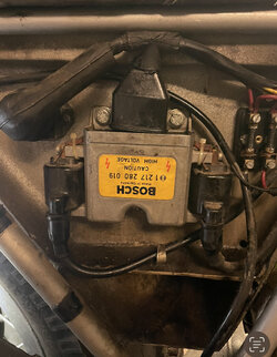

I only have spark on one sparkplug. I think that problem is in electronic ignition/coils.
Does anyone knew where can i buy NOS or used ignition?

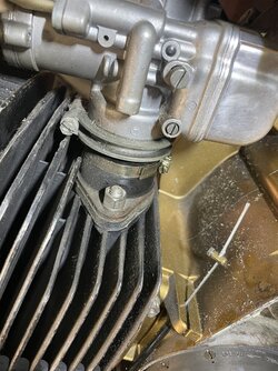

And i also need carburetor intake rubb

Hi ludiluka, I could offer you some parts like a original manual, a NOS ignition box and maybe some rubber parts also. Carburator intake manifold is difficult to find - same part as on 500 Formula. For oil quantity see my scan of the manual. Contact me: gert.schnoegl@netway.at

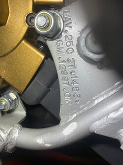

Another question for experts. Can somebody tell me what year was bike produced?

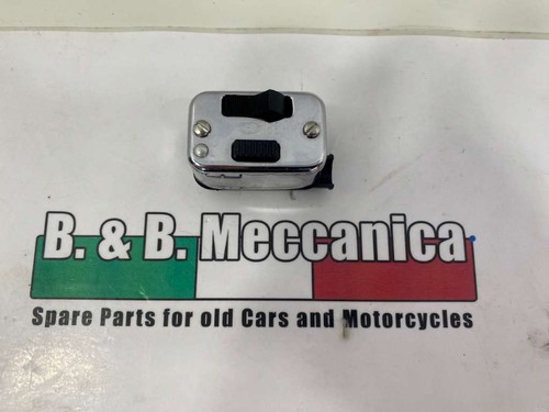

New day new problem. Does anyone have spare handlebar switch that is willing to sell.
I will buy complete switch or just internals.

for sure Moto laverda did not make that switch, its generic alright, and I think made by CEV, later Chotts had a different and much more bulbous all plastic item, also generic.

Just write the reference number into Google and I'm sure you'll find a replica. A lot of old CEV stuff is replicated.
