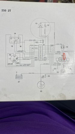

New day new problems with the chott. As i'm not familirar with chott electrical system i would need some help. I los spark on both sparkplugs. So either bosch unit or something with coils inside of the engine. How can i check coils in the engine what outputs should i get on the wires coming out of the engine?
Is somebody willing to measure what is output from this wire (in my case wire is not purple. There are three wires in the connector one is red second is 2 brown wires to the same pin and the third wire is the correct one) when kicking bike over.
Unplug the connector set multimeter to ACV one probe in the connector that goes to the engine and second probe on ground.
And same thing just measuring resistence ohms.
Im trying to find out if my pickup sensor is bad or bosch electronic but i can not get any data what should be output from this wire.
