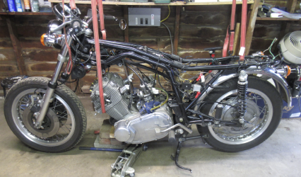

After getting advice from here and others, I've decided to pull the cylinder off to see what's inside and here it's almost ready for that. A breaker bar locked against the foot peg kept the engine locked and the leak down test had no hissing anywhere on both cylinders w the valves closed and motor at TDC. I'm hoping the wear marks aren't too deep and a hone is enough. A friend who has a machine shop will measure the clearance to determine the next steps. This is the second time around taking it apart so I'm getting pretty good at it !
At least you'll have peace of mind, Ted. Once the head's off, with valves closed, pout some kero/parrafin/petrol down the ports and see if you can see any leaking past the seats. I'm wondering why you have a discrepancy between newly rebored cylinders. Good luck with the measuring and hopefully a hone and spirited run-in will get the psi up and even.
