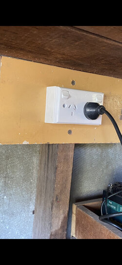

Love the GPO ( Power point ) on the wall, incoming exposed twin and earth TPS on narrow stud, at risk open space behind the mounting block, send the inspector around in the morning..... sorry could not help myself, still carry an electrical contractors licence... the oft "how did you know it was diy electricals" dunno just a guess.... non plussed look on face... BTW dont ride that bike much i guess, tits still on the tyre.... let alone the painted numbers.... sorry and not sorry jon....a laugh here...j
SO (socket outlet) these days Jon 😉 and a wry smile here 😁
Yet another designated item name change is it, am obliged rowdypat. Ho hum....again.... most probable this will be my last year of contractors licence, then again it was hard going obtaining it, so will change my mind again, the very aspect i accuse AS3000 of doing... i caught the infection from the authors. Not so much of a grin here, resignation more aptly...j

Here is a pic to make sure you can sleep at night and I'm sure is of way more interest to the original poster of the question regarding
LED indicators.

Well done Tom, nice...B pass, if you put the small white caps ( found in bag or spares on the rear of the outlet ) to cover the UNC 6-32 screw heads, bump that up from the B pass.... yes its the little things the apprentices would have grief over... your quick i will give you that Tom... not much fun working close under a bench, oh my back....j
