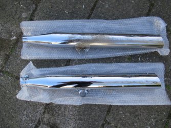

Bought a new set of exhausts DGM 5933 S for my 1972 750 SF on ebay. But they turn out to be much much louder than the old ones; they looked the same to me (old and new in picture). So 2 questions. Are there different grades of loudness available? And how can I make these ones more silent?
Hope there is a simple solution for this.

very early ones had a bolt on the rear bottom, which if you removed would allow the baffle to slide out, and could then be repacked, not that there was much of that going on!
DGM 5933 S stamped exhausts with the slash cut at the end come in different qualities.
I have 2 sets, one heavier than the other and quieter.
Purchase origin unknown of both sets, but the heavier set is made of thicker steel, has better chrome and fits better.
HTH
Gerald

if the internals of your silencer are original, what you should see inside is an inner skin, in the shape of a reverse cone megaphone, the outer is just a skin for styling, inside is the reverse cone with the packer after the cone. that may be why one pair is much heavier than another, the later SF1/2/3 system with the under gearbox lean angle limiter and the Conti type silenecers are very much quieter, , but beware pattern lean angle limiters are very often "empty" and they should not be.

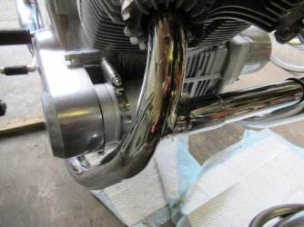

Yes, please post pics of the silencer internals. We can then look at some simple mods to slightly lower the sound levels. By your description, My silencers are like yours and I find them too loud. Unfortunately mine are welded shut so I cannot easily improve them.
