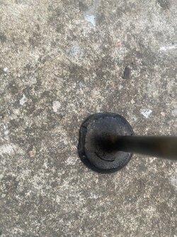

Was expecting to find the valve clearances at zero and all the valve seats recessed away as has happened to my early 3Cs but was surprised to find all but one of the clearances as they should be. Ex#2 had halved to ~5 thou. suspecting a sticking or, worse, burnt valve I took the engine out yesterday and this morning found #2 ex valve to be a little out of shape...
So.. What might have caused this? I haven't altered the jetting since... 10 years? Valve to guide tolerance is fair and the same on all valves (not new but not rooted either) Compression on outer two was ~115psi which seems reasonable for 8:1 compression ratio.

Valves have done upwards of 30,000 miles and both they and the guides are still in pretty reasonable fettle. Mixture looks to have leaned out for some reason and cooked the centre pot's ex-valve. Not entirely sure why though suspect Piet is onto something with his theory above (just have to get my head around it a little better yet). Will likely just throw it back together after a light hone with new rings + a valve.

The tops of all the pistons look to be a bit on the white/cooked side so it's just as well I didn't burn one though (lucky the old Mondial Slugs are solid aluminium). Bad fuel isn't beyond the range of possibilities: that said the garages do move a lot of fuel out that way and I do use 91 to avoid the pitfalls of country 95 syndrome... I had been adding a squirt of Castrol R as a sweetner (and also for the hell of it) at each fill up...
