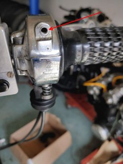

Just bought a 1970 GT. On the way home I lost a bolt (the adjusting screw). What does it adjust? How to adjust?
Picture of the whole bike please- the bottom one’s a friction adjuster - that threaded hole is for a screw & locknut throttle stop- stops you from stretching your cables- still available as a spare part, look up Tomaselli Daytona. You could just blank it off with a small screw .

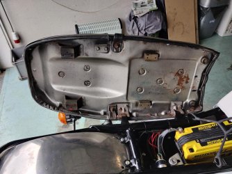

Ignition switch or battery isolator under the seat?? I’m intrigued by the handlebar switch next to the throttle as well- rear shocks are arse about face but doesn’t make a lot of difference. Fuel off every time as Marxy pointed out, if it floods and you hit the starter it’s not going to be pretty.
