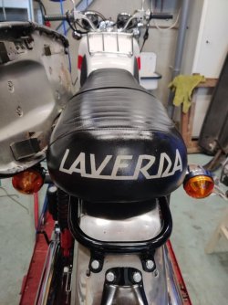

Just bought a smaller 22 Ah battery.
And now looking for a original saddle.

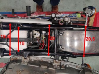

Where have you measured your frame width?New seat does not fit, my frame is 20 cm wide.

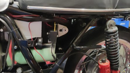

Relocated the ignition switch, new location is not ideal but not the final place, just for now. At least the saddle is fixed in place now.

That's a "narrow " frame so any 750 saddle from mid 1970 on will fit, excepting the hinged SF3 type.See picture.
