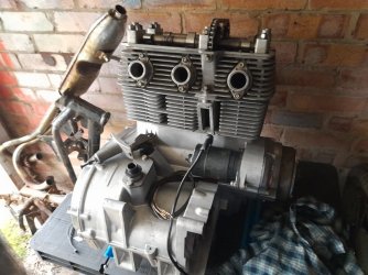

Torqued the head down ok, timed up fine, need to polish the cam cover and sprocket cover and reassemble. All done as cheap as possible so far. I'm going to try and work out how much this has cost when I finish but even being as tight as possible it would definitely be better to buy steverocker62's Jarama off ebay. Still I am enjoying doing this bargain basement resurrection in my own weird way.
A hint Piet once gave me (and I hope he does not mind me sharing it): let the engine sit for at least one night, then re-torque the head. The head gasket somewhat compresses over night and if you do re-torque the next morning, you a) have done that on the bench, which is more comfortable than doing it in the frame and b) the chances of avoiding a leak at one of the gaskets is much lowered.
I have two engines he re-built, no oil-leaks so far. Re-torqued the head after 500km and 1.000km, all running fine.
