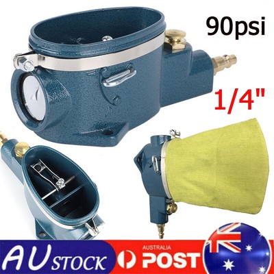

Home plug cleaning may be our new methodology. Less than $50, worth a blast... yes i know its getting worse... puns are not what they used to be... wheres me air hose... just bought one plug cleaner for $36 delivered.
