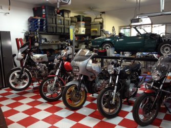

so, the garage reno's are nearly done, done enough that I could start bringing bikes back into the garage from the storage container.
I have the Triumph Spifire car with its freshly rebuilt drivetrain to get running, then finish the 82 Laverda 1200 TS Mirage project, and get both the 79 1200 Mirage and the 84 RGS Executive running (new batteries for both), then start on the 79 CBX Turbo project, for which I have a new to me used Metchamex braced swing arm and a complete front end (bigger better forks and brakes) off an 82 CBX to fit, as well as strip the motor and then get it running, and then, "while I am at it I might as well"........ ;) 8)
the CBX is strapped to a small mini lift, as the 82 Laverda 1200 TS Mirage project is not leaving my large air lift table until it is done, have to keep the priorities straight ;)!
not shown in the second photo are the Kawasaki ZX 14, the 82 Laverda 1200 TS Mirage about 2/3's built, and the Kawasaki 250 Ninja, 8 bikes is getting to be a little much, there may be some culling of the herd coming up.......
Paul LeClair
