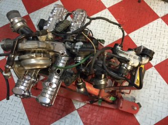

finally gotten back to the 1979 Honda CBX 6 cylinder turbo project.
Front end is off, rear suspension/swing arm is off, wiring harness is out, turbo is out, all the turbo plumbing and intake stuff is out, just about to check all the valve clearances before the engine comes out....
turbo and waste gate are going to a local turbo specialist for re conditioning later this week, all the lines and plumbing are going to a hydraulics specialist shop to be duplicated in modern materials at the same time...
fingers crossed the fancy engine internals are in good shape........
a couple of photos
Paul LeClair

mauricejota7604 said:
Now where is that bolt?
no issues there, I am replacing all the fasteners anyways, most of them are rusty or chewed up. The oil filter cover bolt in particular looks like someone has been at it with a pair of vice grips, and whoever worked on this thing previously chewed up pretty much all the "Phillips" head screws, obviously never heard of JIS or if they had, obviously did not care.  http://www.vesseltools.com/hand-tools/screwdrivers/motorcycle-restoration-repair/motorcycle-repair-kit/flypage_sku.tpl.html
the basic workmanship and engineering of the turbo install seems excellent for the early 1980's, and I am impressed by the work previously done on the cylinder head, but work done since the build seems rather..... primitive, involving crappy crimped Scotchlock wiring all butchered up, with crappy electrical tape peeling off - I have a brand new main wiring harness on order.....
as long as the fancy crank, fancy rods, custom turbo pistons, and all the head work turns out to still be in good condition, this one will be a fun build, doing some modern updates, a new flat slide Mikuni carb, still figuring out what I am going to do for a programmable ignition that will retard timing under full boost, the sorts of thing that were simply not available when this was originally built. Also still need to figure out what I am going to do about a wider rear wheel and offset front sprocket etc. to go with the Metmachex braced swing arm I still have to figure out what fitment machining may be required.
