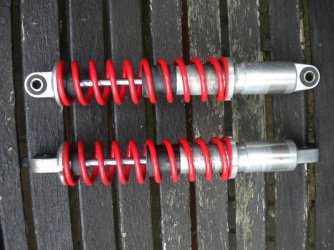

I have a set of Hagons on my 500 Alpino and have to say I'm not too impressed with them. They work OK but do let the back of the bike move around a bit during spirited riding. On the rest of my fleet I am using shocks from Wilbers and these work great. Unfortunately the prices have gone up the last couple of years and the official price is ?799. Dealers get their discount (I am one) and if you order any Wilbers product in the month of October there is a 10% "Oktoberfest" savings. Wilbers gives a warranty and set the shocks up according to your weight and riding style. Another option is if you want the original length or a bit longer to help sharpen up the handling. The ?hlins are probably the cream of the crop but then you will have to pay accordingly. I've heard good and bad comments with the Ikons (ex Koni) and with no personal experience with the things I won't travel down this path. I would think the best solution is to figure what sort of budget you have and how you actually ride your bike. If you are a thrasher speed demon stay away from the Hagons and the like and if you simply putt around looking at the world the ?hlins are simply overkill.
