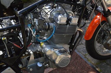

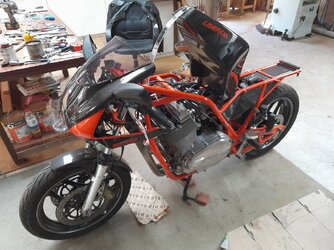

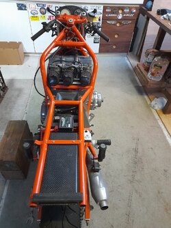

Hi
Here Can you see the engine is raised on my Endurance racer , the bike
Is for sale:
