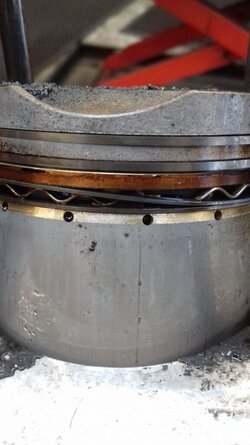

2) Oil coming up past incorrectly fitted oil ring (again by Moto Corsa) plus ring recesses worn and out of tolerance. So barrels off for rebore and new Omega pistons (supplied by Keith).

Bloody hell. Someone (at Mota Corsa?) needs a kick in the arse for fitting the oil ring like that. I don't think it could have got messed up like that in service.
You should send them that photo. I doubt they'll acknowledge any fault, but it's valuable feedback for them if they want to improve their quality of work. They might take a bit more care with the next bloke they do work for.

"this must be bodged fitting of valve guides (too tight tollerance) and they are probably binding on the stems and riding up and down with the valves" looks like I might have been correct, but the oil control ring beggars belief and would have made some funny noises and cause a bit of oil burning right from the word go as well. What are the visible marks that can be seen lower left on the piston wall in your shot? Moto Corsa is being blamed for the oil ring defect, but didnt you state that Ged had honed the bores and re-ringed the pistons?

I was reading through this posting set from #1 and got right to the penultimate post and thought to myself that

Ged showed the piston to me when I was down at his place Clem, I very much doubt that he fitted it.

Ged didn’t do any work to the pistons, he only serviced the bike at the beginning of the year. And buggered if I know what the marks on the pistons are, I’ll ask Ged when I see him.
