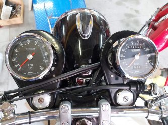

Does anyone have an early SF model with Smiths clocks. I am looking for images of what should be there. Mine has a little box with some indicator lights on it, It looks home made but I want to see what it should look like, the clocks seem fine and looks to have original mounts

The only lights on machines with Smiths clocks are in the headlight. The big Bosch headlight "? la BMW".

Thanks all, very helpful as ever, especially the view of the clocks - exactly what I wanted
