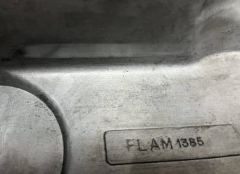

The old one has made a nice job polishing the inside of the case.
If only I could get it to do all of the outside of the cases.:unsure:IMG_8304.JPG
a bit as Paul says, but wash it in parafin and then oil it, they always look slack, there is no adjuster, its not needed, it only turns when the starter does, the belt is a Z495, that is Z section 495 mm length, online for less than a pint of Mckewans.Ot pickup from Bess at Toogoods, South Godstone.
As previoiusly said, for the chain IF YOU REALY MUST shorten an old triple cam chain. easier if you get the extractor from the club, fiddly if you dont.
