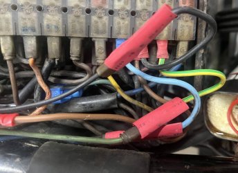

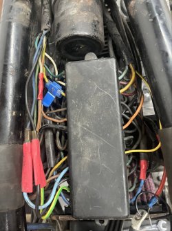

Thanks for that picture, Mark. It confirms that the black plastic box, on mine, is original and, also, how the regulator should be mounted. At the moment it's hanging from a couple of home-made rubber straps, one of which has failed, the other about to, on bolts that are too long. The PO obviously didn't own a hacksaw.
I'm going to have to tidy up the wiring, too.
I absolutely hate Scotch Locks, and those red crimp connectors not much less. Love the use of domestic power supply wire of cuts to extend wires. At least, he'd manage to get some heat shrink, albeit not the right size for the job.

Yes that rat’s wiring nest is an “endearing” feature of these 750s and I’m always afraid to touch it when I remove the tank. If I was more electrically savvy I’d redo it, so anyone who,s done that please offer some pics or info, thanks

The big reveal? All that remains is directly related to Teddy's comment above: rewiring that horror under the seat. Unfortunately life is getting in the way of solid workshop time and even our big trip north and into Indonesia is being curtailed.

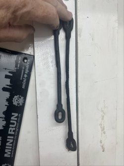

Speaking to Phil Todd, he suggested that the tank should be a tight fit on the front rubber buttons. Upon examination, the ones on mine were extremely sloppy. The strap, also, had seen much better days.
On Ged's recommendation, I ordered new ones from Mdina Italia. The new strap made it obvious how shagged the old one was.
I'm pleased to report the tank is now secure.

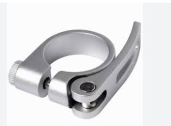

How about adapting something from a bicycle quick release? Seat posts use them as well as wheels. they're usually a small (M5) thread but I reckon you could easily recut to M6 or even M8 ... nice short alloy lever ... bingo!
Can even get them chromed in M8.

I finally worked out why the standard wiring had been extended, using domestic mains cable, the handlebar switch cable had been misrouted. Re-routing the cable correctly, allowed the bodge to be removed.
