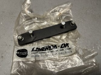

Here's a NOS original one, from Denmark. Came with the Bosch regulator attached, now on the Segoni.

There are some tired looking electrical wire and connections Hamish, redundant scotchlock can get the flick. Of note, blade compression tool used on the various Faston/quick connects ( 6.3mm ), may or may not be reliable, sure you have the proper ratchet crimps and dies for embossed crimping.
Somewhat of a conundrum with old wires and tired connections, wire to connector corrosion that is hard to see from a visual. Ignition circuit ( 12 V ) starter, and lights a priority. If pressed i would renew all the wire/connections to the ignition as priority, even if that meant bypassing the oem electrical system, altogether. Have done this in past times for urgent reliability mantra, a full rewire is a big job in any man's world. Skill is on your side. j
