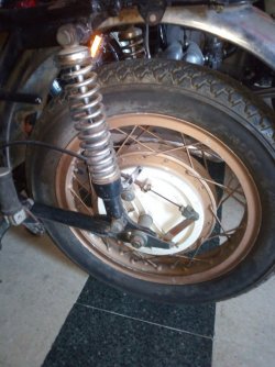

I have a set of wheels in brown on my new one , that would match yours ;)

Brown? Nah mate that's a genuine magnesium rear end....
