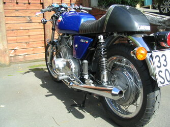

I spent more than NZ $8000 juist on parts to bring my 1975 up to scratch.
And it wasn't a wreck to start with
That included a crankshaft rebuild with new (Carrillo) rods.
All the work done myself, so if you have to farm it out....mega bucks
That included a crankshaft rebuild with new rods.
But a very nice result👍

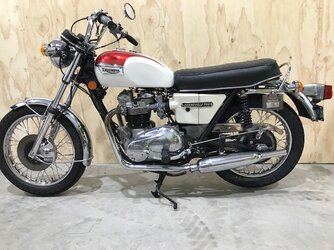

Just be prepared to pay what it costs with the SF3!!!! no good having a half job on any bike in my opinion just asses the risk, mechanical failure (big bang) or even worse broken down on the side of the road and having to go home on the back of a Bonnie!!
That's a particularly specific Bonnie Maurice. Not a 72 with a conic hub front brake or a 76 with a disc rear. Halfway between. Never seen a white one either. As to that SF2, time moves on obviously and you cannot compare a 73 model bike with more modern bikes just as Machines only, you have to allow for when they appeared in their own time. Just me being a preachy dick, I like lots of different bikes, I rode a WLA around a car park once and loved that experience, but it wouldn't be my first choice on a sunny Sunday.
