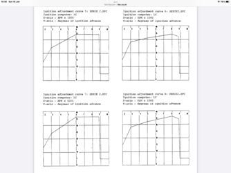

I haven't had much to do with DMC units. The man to ask is Piet. I believe he was involved in the development of them. He's very knowledgeable about them anyway.
The optimal advance curve for your bike will depend on the state of tune of your engine. As a general rule, higher compression engines require less advance than lower compression. I don't recall whether your bike is a Jota or a 3C(L), but the recommended DMC curve would probably be different.
