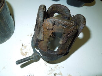

Most probably the field windings will look like those in the pic. As Cam has described, most current simply flowing into the casing instead of powering the field coils. It's not only the insulation between coil and casing, the winding insulation is usually no longer existant, re-insulating is rather difficult. Armatures rarely give up, most are fine with a clean-up of the commutator and a thorough de-rusting. I can supply NOS field coil sets.
Thanks ,if I need them I’ll be sure to ask ,didn’t remove field coil’s they looked ok but without removing it’s hard to say ,do you have a brush set ? And if not are they available from anyone in the uk.and after speaking with cam he said you’re the man to speak to about dmc 1 advance curves , I have a 1977 so I’m told jotaised motor 10.1 pistons 4c cam 32mm delautos and am fumbling through the 8 curves that are available,so far I’ve tried 2 4 and am currently on 7

I can supply individual brushes, but the leads came out a bit short, thankfully only at one end. ;) The brushes fit nicely and are of the correct grade, just a pita to install in the brush holder. I could offer an overhaul, but thanks to Brexit, that's no longer possible.

I don't know if it been said before because I haven't read the whole thread when it got a bit lost but here is something that I have found, the brushes? they may well look good and could even be at about the "half worn down" stage and should have plenty of life left in them, if the brushes have been replaced, then it is necessary to solder the braided cable to its post inside the starter, when new this is (hopefully) done well, but I have seen two starters that have had the brushes replaced and failed after not very long, this was due to much too much heat being applied when soldering the braid and it fused a large section of it, flooded with solder by capillary action, and so hardening it, removing a good portion of the braids flexibility, which is why it is braid, this caused the spring to fail to give those replaced brushes good contact, one was done by me (oops) and the other by a professional electric motor re-winder, take a look and see
