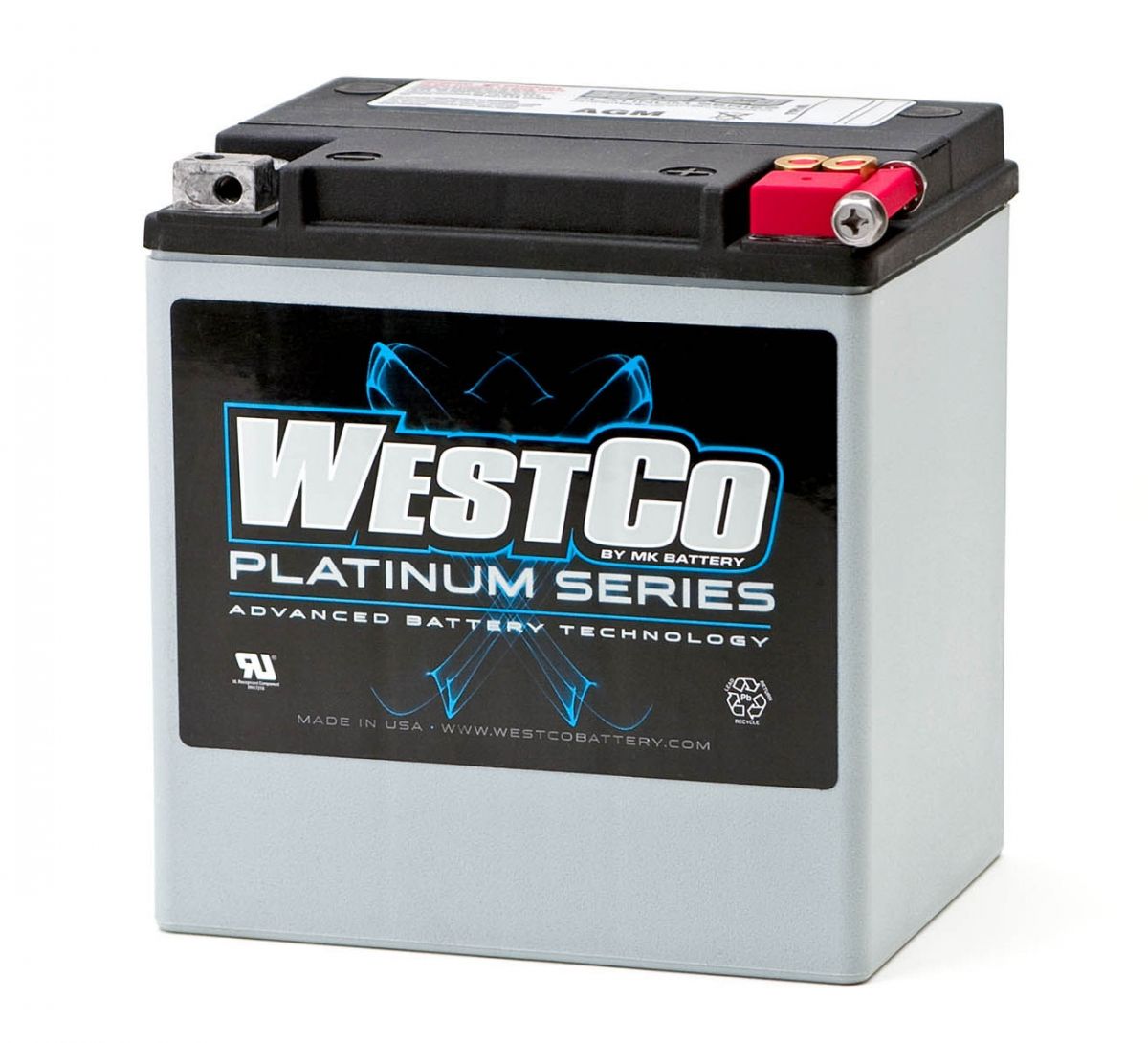

Maybe too late, but I use these on 2x Laverdas and 1x Ducrappi. 400 CCA. Went off Yuasa years ago.
WCP30 Westco Platinum Motorcycle Battery 12V 26Ah
