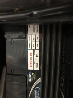

Using one of these in the 3cl, cost a bomb...... had to buy the bike to get it 😜 had it for 5yrs previous owner 2, bike sits for couple of months without being run, but when called on fires on the button. Never had a Battery spin up a Lav as quick as this bad boy 👌🏼 Never had a trickle charger on it either!
