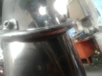

Imagine following scenario; Casually cruising along at 80-90km/h without a care in the world when suddenly the dozing cage driver in front of you decides to hit the brakes because he missed his turn-off. You have just enough space to "safely" slam on your brakes to avoid rear-ending him. But your mudguard bracket whacks into the centre header, ripping the handlebars from your grip (casual, remember?) and turning the front wheel full lock. You find yourself sliding down the road on your face, quicker than you can mutter "WTF?"

Stiffer springs will not prevent the contact, only limiting fork travel might. Check distance between front axle and front engine mount with fork fully extended and compare to a known, accident-free bike with same type of fork.

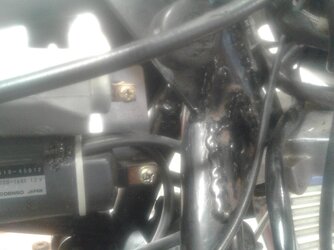

I've seen this sort of damage dozens of times, it's always been previous crash damage. The pictured frame is just one of many and had apparently been used for quite some time in its damaged condition before being "repaired". I advised the owner to replace it, not only was the top tube mangled beyond repair, the headstock was gusseted with snot-welding and the wheels were no longer aligned. He was completely unaware of the situation, having bought the bike in this condition. Crap pics from a crap phone, sorry.
"Repairs" to this issue have also included cutting out a section of the rear mudguard loop, or fitting a later mudguard without the loop bracket.
The motor needs to remain in the frame as a structural support. If the motor is out and the frame and is straightened the motor mounts may not line up upon reinstall.
