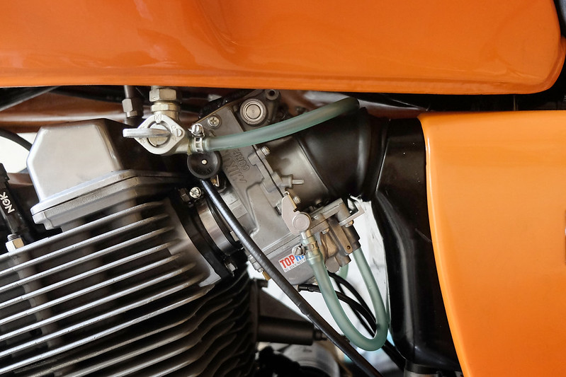

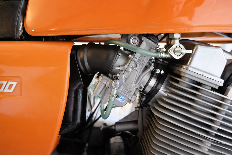

I managed to connect the original intake snorkels with the Mikuni RS36 and the original airbox. The snorkels, however,
are pushed a little further into the airbox.
It did not work without modifications though. I had to take out the rear wall with the filter and position the whole
airbox a bit higher. Thus I will drive the first test kilometers without air filtering.
The main jets seem too big for my brave series engine (130s), I will experiment with smaller ones. Further Lothar
was right ? I found one foul spark plug.
Cheers
Jo

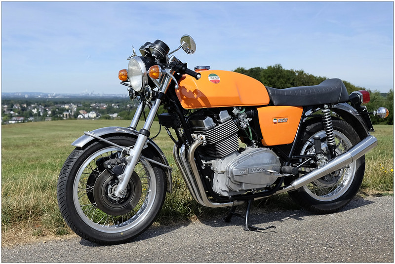

Yesterday I did the 1st longer ride after the modifications described - on my way back home I took this picture above
Cologne bay (Cologne Cathedral on the horizon):
8)
As for the Mikuni Carbs: Smaller mains are ordered. Medium term I will install a lambda sensor in the collector to do some
fine tuning on the carb set-up.
Cheers
Jo
