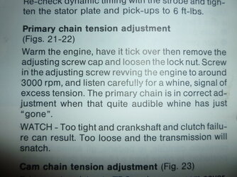

My inspection plug is only for ease of maintenance to get the "tension" "right" ( or correct as the workshop manual says ) without any guesswork.
The reason Laverda never produced one was maybe cost, same as with oil filters and maybe a few other modifications that a lot do to these bikes ( even though they worked without in 50 yrs ).
And, I know some hamfisted / bad hearing owners that rarely could get any tension correct depending only on hearing and feel through a screwdriver.

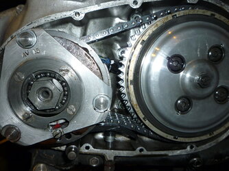

Pick of primary chain grinding marks on crankcase edge, slack chain trying to climb the front sprocket on downshift engine braking. Not a Laverda as can be seen, but same chain and and type of tensioner.
