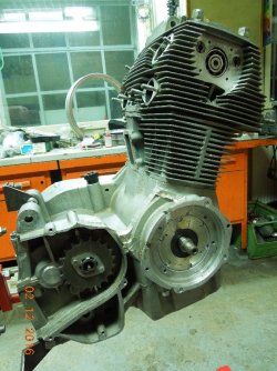

This particular engine is pictured in the SFC Registry book on page 60, the one without the starter motor flange.
Standard SFC-type cast Asso pistons were fitted, the same as all '75-'76 750SFC had when they came from the factory.

sfcpiet said:
Paul,
....the one without the starter motor flange.
To me, the missing starter flange at this picture looks more like it has broken off. Grinding away or milling leaves other traces.
The first 30 years I have repaired Laverda engines, I had never problems with an starter flange.

Thomas,
Nobody ever claimed the flange was broken or damaged.
The starter motor flange has been intentionally removed.  This engine was used for short-circuit racing, therefore there was no requiry for either charging or starting equipment.  All this added up to a total vehicle weight of only 150kg, dripping wet.
The engine was fitted with a simple Dansi flywheel magneto which showed evidence that at sometime it had run with a 180? crank configuration.
Thomas aus LAU said:
May be. In my opinion, the material of the crankcase would look different after sawing, grinding or milling.
Best Thomas
Rest assured, the flange was most probably simply hacked off, the edges have been smoothed manually with a pneumatically driven burr or similar.
