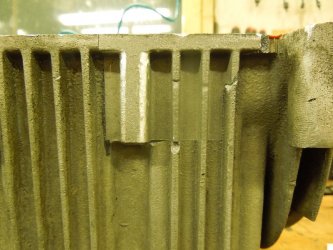

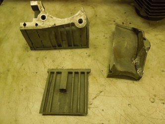

Made some spare parts and cleaned up the ragged edges...

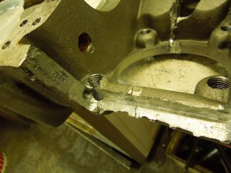

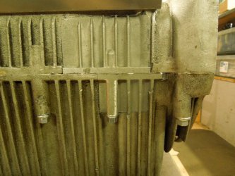

Started fitting the bits.
Recieved a precision ground steel plate today to fix to the cylinder base surface in order to keep everything straight.  Both cases are still surprisingly true at the mating surface, see how it all goes when it's bolted up for welding.

The bits were donated by a knackered crankcase that had been destined as a crankshaft transport container.  Hadn't been used for decades.

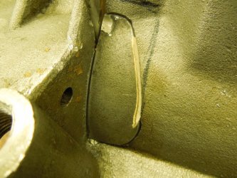

No such sophistication here Gerald.

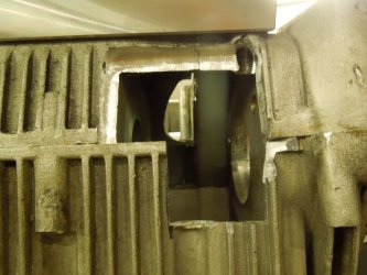

Donor case was hacked to bits with an angle grinder, quick, but messy and loud.  I had to be sure there would be enough material to work with, so the cuts were well on the generous side.  The window in the lower case was cleaned up on the milling machine, turned out nice and square.  Patch for the lower case was shaped on the mill, as I had the dimensions of the window in the case.  That was the easiest bit.  The rear hole was cleaned up with a carbide burr in a pneumatic grinder, the patch was shaped entirely by hand, checking and re-checking for fit.  In the pic, that's a bit of cardboard jammed in to hold it in place for the photo.

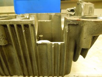

Made a lot of swarf today, fettling and fitting the front patch, pics to follow.
Next installment...
Was a bit fiddly! :D
Unfortunately, the shape of the cases differ a bit, the curvature and ribs are not an exact match.  But I reckon you'd need to look closely when it's done.  Bringing it to the welder Monday, will probably take until the end of the month.
