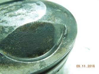

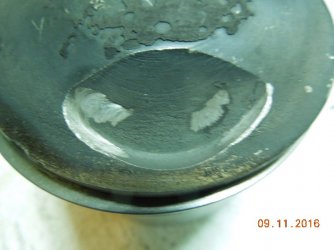

Clem,
The engine would originally have had the special narrow valve angle head with the special cams and rockers.  And the special pistons to go with it.
When aquired, the engine was fitted with a elletronica head, barrel and pistons.  All valves were bent because they had kissed the side of the valve cutouts in the piston crowns.  Turned out the crowns were not correctly machined with the cutouts at about 80? to the cam axis.  To me, this points to manually machined pistons, maybe prototypes for the elletronica?  These pistons were re-worked with a Dremel and re-fitted.  New NOS elletronica valves were also fitted.

High dome and a totally different squish system to all the other twins which have a flat squish band on the head and piston - very easy to set up to the desired 1mm. The angle on an elettronica head must relate to the outer edge of the piston as seen in the Piet?s pic. Many earlier engines (Duc single, many older cars) had this system, much harder to set squish.
I have seen numerous hard ridden SF pistons where the valve cutouts do not match the valve angle, with contact lower down in the cutout, maybe happened on valve bounce, they also needed a dremel job to avoid contact.
I fitted those electronica pistons with a 5C cam before I had learnt about correct setup. I really didn't like how they cracked between the oil relief holes in the oil ring groove and the gudgeon holes both sides of both pistons. Modified standard pistons for compression and squish work great in an SF.

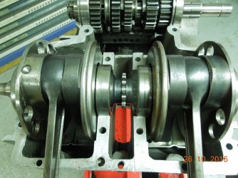

Been quite some time, but things have been happening!
After the welding, the case distortion was unfortunately not acceptable, almost 4mm warpage diagonally across the case mating surfaces when placed on the marking table. I had not expected this amount. This turned out to be quite frustrating, completely deflating my incentive to zero for a while. After a deal of researching, another flat-ground steel plate was sourced late 2023, lots of holes drilled and one after the other a case half was bolted to it and shoved into the oven for around 10 hours and 250° (all my oven can muster). After slow cooling, warping was already considerably less, but still out the ball park. A length of 90mm steel bar was transformed into a crankshaft dummy and the cases, bolted together with the dummy installed, went back into the oven again. After cooling, I simply let the assembly rest, over a year! I finally seperated the cases last September to find they had taken back their proper shape to within 0.5mm when measured diagonally across the mating surfaces, about on par with a set of old, used stock cases. The actual hardness of the alloy does not seem to have suffered. Pretty chuffed... ;)
In the meantime, I had the chance to aquire a nice set of used Electronica pistons and barrel to suit, one less worry.
The upper case half is now with an engineering company to skim over the barrel base surface and re-drill/thread the stud bore. Hoping to recieve it back by the end of February. Ultimate goal is to have the bike runnning for the Nürburgring event in August.
