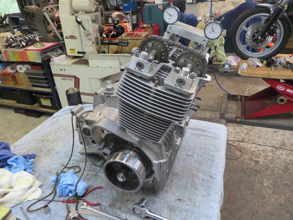

I dial in the cam timing on every engine I build except for the 750 engines as that is a fair bit more difficult to do
But on the triples it is very rare to find an engine that matches the Factory specifications for the Camshaft in use
Have found triple cams up to 14 degrees out, is not that uncommon at all
Is a straightforward fix, set Cam wheels up on the Milling machine with a Dividing head, drill and tap a series of 7mm holes
Each hole gives you approx 3.25 degrees shift in cam timing, set up Timing disc, Dial gauges to find exact Cam lobe center
Work the timing until within 1 or 2 degrees, machine new Timing marks on the Sprockets, job done
Is not that difficult, on my Race engines I used blank sprockets and vernier drilled them so I could set the Cam timing to my own specifications
Cam Timing 4
Cam Timing engine 2
Cam Timing engine 1
Great jig for your DTIs. That would save a lot of faffing about.
I must be missing something. 360 degrees divided by 14 would give 25.7 degrees divided by 2 gives 12.85 degrees per hole adjustment?
