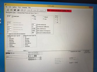

FINALLY got every thing installed and talking to each other.
Saturday the bike would start but would not rev above idle, the slides are lifting when I twist the throttle and there is fuel. Tank cap open or closed makes no difference. Today after running the Ignitech programming screen the bike will no longer start.
I saved the screens but could not send them to Ignitech as my IP did not like them and I assume they were too big to publish here.
Last resort I have photographed the screens and I put them here for you to look at. Can you tell anything from them? Have I shown the correct screens?
Oh, as a PS the graph showed 35 degrees advanced.

Those pages look very unusual to me, Robin. I'm guessing when you 'Programmed' you've created something that simply won't work. It may be that with a different 'Bike' type chosen it sets a default, but mine below as examples (using a 'Classic' setting) look totally different - and yours look totally different from other pages for triples that I've seen from Red as well. I'm sure he can tell you more with regard to the settings he uses for triples, including sending you an .ign file that you can simply load and Program to install into your unit. The more you play with the settings the more you learn - and the more you realise how it's not particularly intuitive.
View attachment 93188View attachment 93189
Thank you for confirming that mine is not right. I have sent the same pictures to Ignitech and I hope they come up with a solution.
