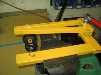

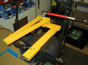

Lock down gets you do these things that you put aside for " later"....
Cheapo gauge , calibrated with water
Spreadsheet does the rest
Both my torque wrenches weres slightly off , so calibrated the " big" one for the upper range , and
the "little" one for the lower torques.
Jig is a bit overkill, but made from old stuff kicking around
Analogue gauge would be better to determine the "click off" point I reckon..

Well done. You actually went and did something practical while the rest of us were theorising. (y)
Don't put too much torque on it though. That the piss-weak cheapo strain gauge looks like it could easily be ripped apart by the massively over-engineered torque arm :) . I've actually got one of those little electronic luggage scales somewhere. I forget what it maxes out at.
OK, next step, let's get rid of the cheapo spring guage (which will have shite repeatability). How about cutting out the middle man and lifting the water direct? Turning the whole jig 90 degrees. Accounting for the mass of the arm naturally.
I don't think there is a spring in that gauge, and as said, it was calibrated with water.
But yeah good idea.
Let us know how you get on
