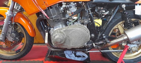

Some changes to the team and bike have taken place since last years race at Paul Ricard.
I have a new riding partner a chap by the name of Tony Jimenez.
I have reduced the wheelbase even more, it was already less than standard from moving the head stock through 4 degrees .
I altered a standard swingarm ( big thanks to Nick Alcock who supplied one) to enable a 104 520 link chain to be used now. Wheelbase now comes in approx 1445mm. Due to the rules / regulations I have had to make and fit secondary covers for the primary/ alternator and right hand clutch cover. Turned up a titanium front wheel spindle , well saves a bit of weight! Also wired up a pit lane speed limiter.
Andy
