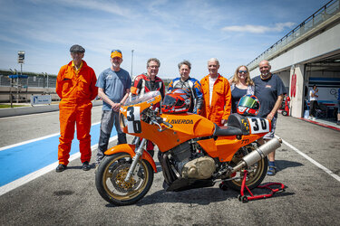

What Andy didn't mention was the awesome teamwork from the Laverda TT1 squad. A small, neat team, with fewer resources than most in the pit, but still running well. Efficient, organised and engaged.
In Garage 7 with the Laverda was a well sorted Suzuki team from Derby who also only had 1 bike. It broke down and had to be pushed back to the pits where over 1-1/2 hours were spent trying to fix it and the dodgy electrics. They only finished due to some proper bodging - strapping a torch to the fairing and a cycle rain light to the tail so they could complete the very last lap at midnight.
In Garage 8 were two professional Suzuki teams from the UK - Classic Suzuki Spares and Phase One endurance. They had professional racers (Danny Webb, James Ellison, Ant Hart etc.), they were very well resourced with teams of 12, but neither of them finished.
In Garage 6 was a lovely Ducati team from the Netherlands alongside the van-der-Mark team from Holland (yes, THAT van-der-Mark) who were on Yamahas. They both had two bikes each but the Yamahas gave up in the first hour, however the Ducatis actually finished all the race.
Endurance racing is HUGELY popular in France with a lot of people there over the weekend, but the attrition rate is very high for these old race bikes.
Andy and Tony were flying in practice but reliability is what wins you races, and sadly the TT didn't want to play last weekend.
