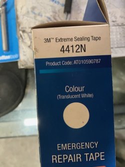

Reunited Chris put me onto the 3M extreme sealing tape for converting the 3C wheels to tubeless. This stuff is awesome, no problems for over 25000km. Unfortunately I had to remove it to re spoke the rim after breaking a spoke. The tape is no longer available in 2 meter rolls. You now have to buy 16.5meter rolls, and to order it in, I have to order a whole box, 6 rolls. Out of the question. I have 3 wheels to convert, so the search is on. One suggestion is butyl tape. Has anyone used this? There are tubeless kits available, anyone know what tape they use?

Hi Marty,
do you have the part number of it? might be worth checking other locations and shipping costs to Australia (if not already done)
How did you go removing it? Many types of tape are either really difficult to get off or they leave a mess of residue. Old gaffer tape for example leaves hard dried glue residue. Maybe there are others on the forum that could go in with you to buy a box.
Carb cleaner worked for me, but it takes time to remove all residue.
Outex make a rim sealing tape that looks very similar to the Extreme sealing tape. Worth checking out.
More expensive than a 5m roll of 3M tape but cheaper than buying the amount Marty has been quoted.

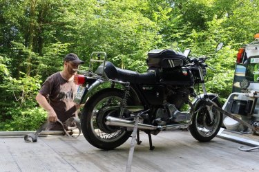

Punctures are a pain. Last month, in a forest in the Meuse, WW1 battlefield and very little mobile phone coverage. My friends repair by the roadside. I'm incapable of doing that.
