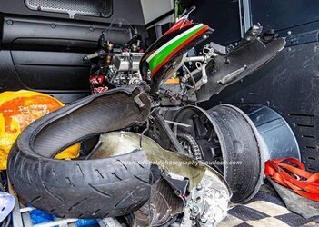

Make sure your tyre is rated for the max speed of your bike.
This tyre was on Jack Frost's turbo Hayabusa when it came apart at over 200mph on Pendine Sands (UK) a couple of weeks ago. Amazingly he stayed on the bike and came to a stop running on rim of carbon wheel. He was apparently uninjured, but looking at the damage to the back end of the bike, I reckon he got a nasty slap in the arse from the busted tyre.
