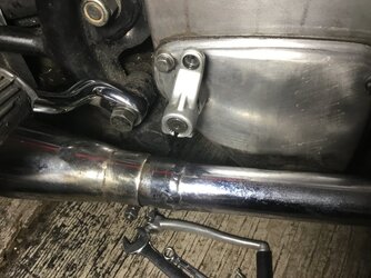

Hi all,
re- my rearsets project on my SF750, regarding the stubby gear-lever I need for the linkage, i have stumbed upon a perfect match for the laverda gear change shaft splines, it is from a Ducati 749, 2003 to 2006, that I found on eBay.
hope this is usefull to other SF owners contemplating a similar project.
cheers, Marty.

I used the foto of the lever on eBay, zoomed in to make it larger, and using a vernier calliper on the image on my iPad, I worked out the spline diameter by scaling from the clamping bolt hole which I knew was 6mm, and then I counted the number of splines, it all seemed to match, so I took a chance and bought it (£15)
tried it on the shaft yesterday and it fitted perfectly!
