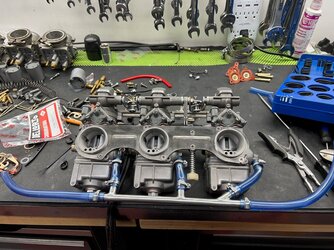

RGS carbs are finished and ready to go back on the bike. All new brass bits, new float needles, new accelerator pumps, new K1 needles, and new fuel lines and new pretty fuel line clamps, all from Wolfgang.
as the dreaded previous owner, I had to do a surprising amount of bending - first the carb linkages to get the slides to all fully open at full throttle with the adjusters in middle position - then the float arms to get exactly 18 mm float height on all the carbs.

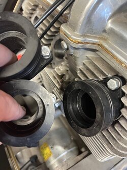

also have brand new RGS intake mounts and new 7 mm bolts. The new but still Italian fuel line Wolfgang is supplying is bluer than I was expecting but is quite thick walled while still flexible. It did take really hot water to stretch the line over the fuel rail. The fuel line I took off had turned reallyy green (not brown) but was petrified, replace out of caution.
still have to change oil, bleed new brake fluid through,fresh fork oil, air up the tires, install new spark plugs, then fire up the bike and vacuum balance and set idle. Hopefully no more surprises, then i will move on to the 82 1200 Mirage, get that ready for spring, then tackle the 79 1200 and its various electrical issues....

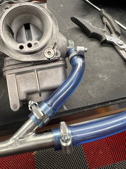

Hi Mark
Your fuel hose routing looks much better than mine, tidier and no deformation in the uel fline to the right side carb. Looks like I will be redoing my two right side fuel lines as well as trimming excess end length from the pretty little fuel line clamps I used........
I ordered lots of fuel line from Wolfgang, will rerun the fuel lines before the carbs go back on the bike this coming weekend, thanks for the photo!!
