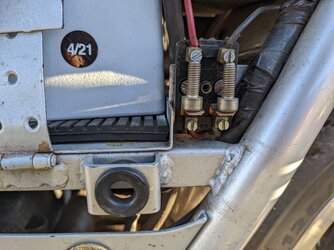

Just got to Tablelands, very long day, I broke down 4 times middle of nowhere. Marmalade is being very naughty. Original wiring loom can't handle the rough roads. No fuses left, running a couple of bolts. Camoweal to Barkly 5 hrs for 260km. 32 degrees in the desert. Road trains don't slow down, first one picked up the side cover with all the bolts in it an scattered them everywhere. Steep learning curve. Glad to be in Barkly, will try and make a set of ceramic fuses from a beer can.

What are the two fuses for? SF2 had 4 fuses, it reduces the chance of some shitty feed wire to som ancillary taking out the ignition. Can you quickly rig up a system to just feed the ignition? No fun working on a hot bike on the road out there.

From experience, you will probably find the fuses are rotating in their holders, building up a high resistance crud (engineering term there) and that is why they are fusing. If you can, find some of those newfangled spade type fuses in a suitable holder. A good auto parts/electrical shop should have some.
