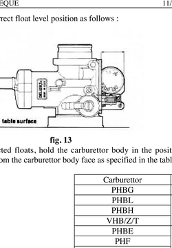

according to the Dell-Orto Handbook, the floats should "hang from above", means you would need to put them on engine side if I see it right on the pic above, not on the inlet side.
Personally, when did the job back in the time I used Dell'Ortos, I did check it with a tool like described above while the carbs were still mounted and connected to the gas-tank. This way (one by one) you can check if they REALY close at 18mm or not... It's a bit messy (needs a lot of towels to soack up the fuel and tiny hands to get in there), but it was the best way to make sure they really close around 18mm. Also, there is a tool to measure this from different sources, like:

Setting the float height, here, fabricate a small right angle bracket with 18m/m inside edge, food grade plastic tube coupled to the fuel inlet, blow air into the needle and seat and test for cut off at 18m/m. Can do it on the engine as a fiddle ( save removing the carbies ). Not sure this helps, j.
Good idea, I tried this and encouraged to find the air shuts off abruptly at the 18mm position. So I'm confident the levels are in spec.

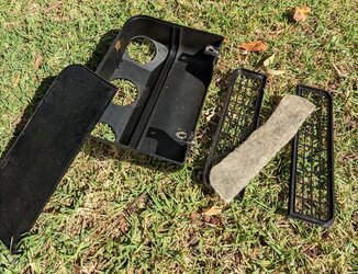

The ideas and efforts are becoming more desperate, cannot help it, a smile here. Here is another one, the air box, does not have a "1200" style metal baffle plate with individual snorkels fitted? To my shame many days once upon a time, using a factory manual it had this low comp piston and K14 needle air box ( USA market from memory to meet noise/intake regs for California ) slavishly installed such baffle, that was fun trying to work out why the 3c engine was well out of sorts.
Learn a lot when things are very wrong, perhaps this topic has the stamp of "work me out if you can", await the next bizarre suggestion, take some to beat my one above... wry smile here. BTW, just for the heck of it, what air cleaner element is fitted? j

All ideas appreciated! I've got the basic OEM air filter box setup (see pic). That is a porous type of material similar to air conditioning filters, but not exactly that. Plenty of air flow.PXL_20230404_025114662.jpg

She said it's called "Quilt batting" and it comes in different thicknesses. The polyester is resistant to most anything. I just wash it occasionally and re-use it. Same piece in there for years
I use a polyester filter media that's used in the aircon industry.
This kind of thing https://au.rs-online.com/web/p/hvac...ZzI_r5j86JfdyDB2Kc0aAv08EALw_wcB&gclsrc=aw.ds
I used to work in aircon design, so I know a few contractors. One of them cut me off about a square metre of the stuff free of charge. That's enough to last me and all my mates several lifetimes. It's about 10mm thick, but will squish into the filter frame of a Laverda triple. It splits into two layers pretty easily though, so I use it in 5mm layers so as not to make it too dense by squashing it down. Just go and ask an aircon contractor if they have any filter media in a roll. Take your filter frame or the dimensions with you so they understand how small a piece you need. The amount you're asking for is only worth a few cents so most of them would be happy to cut you off a small sample for nothing.
