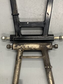

Can anyone tell me of a box section swingarm from another manufacturer that will fit in the back of a 1000 3C frame with a little work?

I think I used one of those (or similar) in the back end of my 500 race bike. Worked quite well.
BTW, I have an RGS swinging arm going spare if you want to go down that route instead.
And although I haven’t tried it, but perhaps should, I wonder if a Zane one will fit.
The Zane can be adapted.
A departed friend raced a triple with Zane front and rear ends.
Not hard to make a rear brake work - you're modifying anyway, so modify out the poor design!

Isn't the RGS swingarm wider than a 3C swingarm? Thought it needed to be machined to fit in the 3C / CL frame?
Gerald
I think you are right Gerald, if the RGS type did fit (I dont think it will) then he could fit an SFC1000 swinger
DYNODAVE
I have Jota swing arm that I will swap for your drum rear brake and swingarm and all the bits to fit up a rear disc, straight swap?
the Laverda swing arm is plenty good enough as it is, the thickness of the tubing takes some believing if you ever see one cut up, underbracing was added by some and this did absolutely nothing, except add weight the same aplies to the Metmachex and other alloy swing arm, (I would like to weigh one of those!) which I dont think they made for rear drum.
