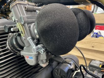

For carbs I went for Mikuni TMR 36- they are making less mechanical noise than the wider used RS 36 model. I looked for a long time for a pod filter for them, and even considered open aluminum velocity stacks. In the end I found the solution with Mirko Messner Moto. Tripple velocity stacks that you wrapped a 10 mm thick filter around.
With a bleeding heart I cut the Mikuni alu velocity stacks in two, so the inner part could work as a mounting point as seen above. He asked me which diameter I wanted and when I said 40mm, he replied: ok we will print them at 40,1mm! They weigh less than 20g each before you wrap the filter around, and give it a little oil.
Only trouble is the right hand lower edge of the crooked tank is touching the filter- I will find a solution.

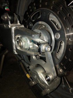

Rear disc is a 220 mm from a mid 1990 Yamaha XT something- Tenere type. I made the bracket for the caliper out of 5mm carbon, and connected the arm from it to the frame instead of the original position on the swing arm.

A question about your carbon rear caliper bracket - does it have a central bearing or bush to allow it to rotate on the axle as the swingarm travels up and down? And with the mounting outboard of the centreline of the disc i think you'll find it is pulling out of line when the brake is operated. The first floating bracket I made had the pivot bearing outboard of the centreline and I clearly had the pads wearing at an angle, which was evidence that the forces were not aligned.
My solution was to have the bearing in a small housing inboard and bolted to the main bracket so that it aligned perfectly with the torque arm - see pics below. You should aim to have the caliper bracket bearing, the disc and both ball joint ends in a straight line. But I can see from your setup that this won't be possible as there is no offset on the rear disc. You would need to make a disc carrier that places the disc outboard so there was room for a centred bearing or bush. i spent too many hours manufacturing my carrier - a milling machine would have helped - I did it all on my little Emco lathe with makeshift milling attachments.hub+disc flange.jpeg

piranha-bro2: I am convinced, that you are absolutely right about centerline mounting is the way to go, but as you say, it is really not possible with a disc without offset. There is no bearing mounted. I have re-used the original bush that was made for the 10 mm thick alu bracket.
Seen here with the iron spacers. Next to the left spacer you see the large diameter part of the bush.Then under the carbon bracket the diameter is smaller for 10 mm (thickness of the original) until it touches the right spacer. Carbon is 5 mm thick and the hole is slightly larger than the bush. To compensate for the thinner carbon, I made a small ring of carbon also 5mm thick, to keep the bracket and caliper in the correct position. Before mounting the arm the caliper could swing completely without resistance around the lower part of the disc.
